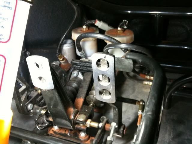

where is this switch located? |
| Back to top |
Posted: Thu Apr 08, 2010 5:52 pm Post subject: |
The clutch pedal assembly
| Back to top |
Posted: Thu Apr 08, 2010 5:59 pm Post subject: |
sorry for such a pic big _________________ "OUT TO LUNCH" and not coming back. |
