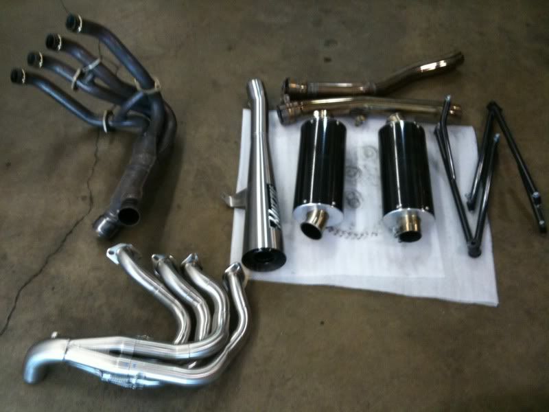

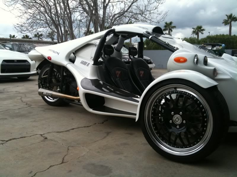

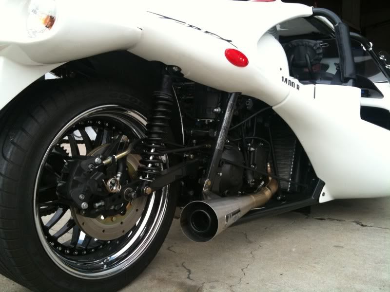

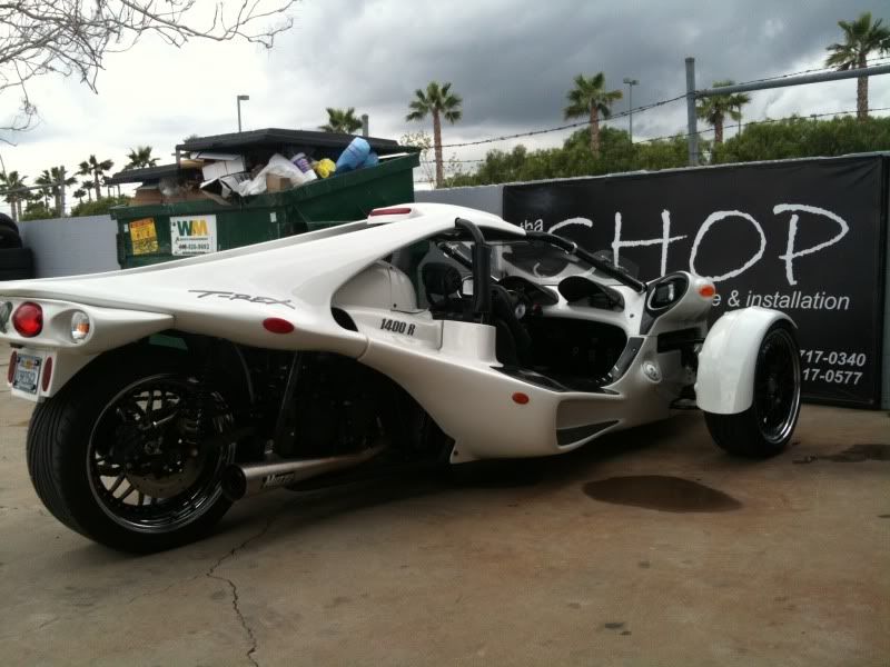

Muzzy sent me the wrong exhaust and yes... most people would just send it back, NOT ME! LOL! I used Muzzy full race side exit exhaust FUN but a little noisy to drive home with (but not to obnoxious). I will order the right one Monday. here are the pic I love the look and feel. take a look at the last pic. you can see the stock cat on the 09-up can you say restriction?(dont look at the trashcan)

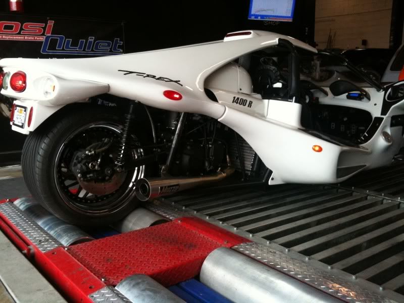

BTW the HP went up by 17hp/23TQ with autotune Smile and no CAT.
for all you guys moving to the PC-V with autotune keep in mind that youhave to drill for the 02 bung and its not easy with the cat.

Nice power improvement! The megaphone looks a little weird. I think it would be cool if they made a dual like that or like my Muzzy shorty. Does the Givi bag still fit on?

Forget the trashcan...Who peed next to the Rex?

I think it's pretty obvious that the Givi won't work now that I see mine. Even if it did go on there, I think it would melt!
Mrs. Chicknfeet must demand to use the other side Givi! I bet when she saw it she asked, "Why did you have it come out my side?" Very Happy
