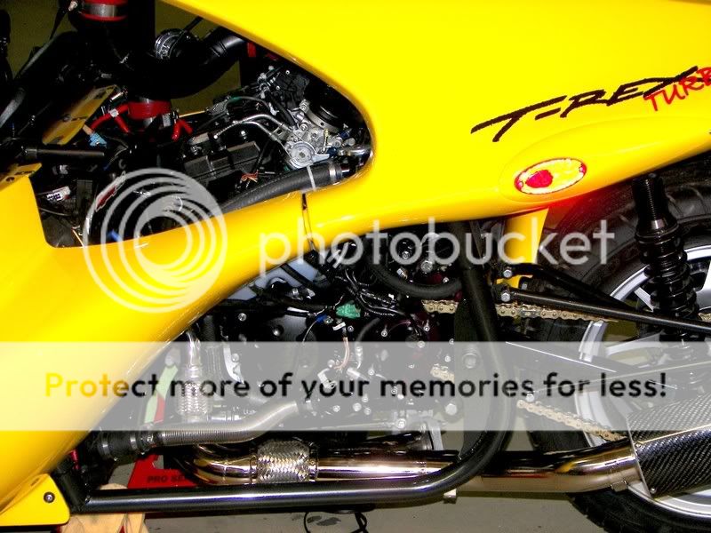

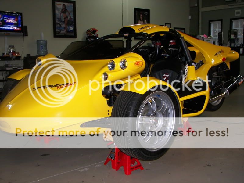

heres a pic. ill be picking it up sunday. im excited!

shes home
some more info on the build. it has JE pistons, crowler rods, stock crank, MR turbo, .30 turbo kit, custom electric dump, custom exhaust, custom intake manifood, 650cc RC injectors, custom one off intercooler, AFR, AEM true boost, its a long long list Smile
