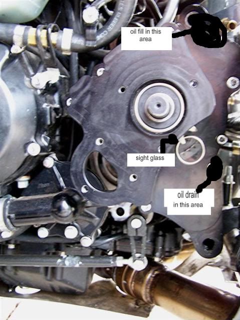

Where is the sight glass for the gearbox? Where is the drain plug? And what is the right amount of fluid that should be refilled after drained? Thanks in advance...

sorry this is the best pic I have from my iphone...
the sight glass is located on the drivers side just lower right of the front sprocket but usually the sight glass is caked with oil so you will need to stick your hand down there and clean it off. on the top you will see a small bolt for filling and on the right closer to the bottom you will find the drain bolt (same size as the fill bolt) if you need better pic let me know and I will get them later. the factory says 7 oz but I have seen from 3.5oz to 14oz good luck!
